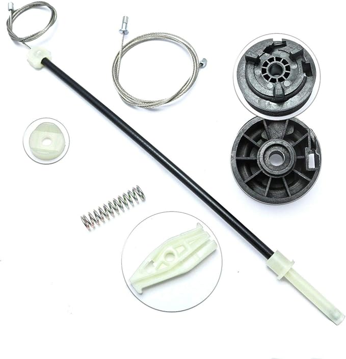

Oh the perils of buying on eBay! Having secured what I believed to be a complete window mechanism (accepting it being used), and relying on the accuracy of the description stating “as in pictures”, should I be surprised when opening the box to find a different one to the photos and with a broken guide piece? Perhaps the joy of finding one overcame my normal caution and “caveat emptor” approach. So it back to plan B and I have ordered off Amazon one of the repair kits sold by Clak consisting of cables x 2, winder spool, spring and cable clip. At £9.95 if it’s not right then I don’t feel as bad as paying out over £100! I did look at the repair kits from LST that include the guide pulley wheels as well at c£70 inc postage.
Has anyone bought either of these kits with success?

Well, I have managed to remove the window mechanism, stripped it down and cleaned it. Why did I wait till November when the weather’s changed for the worse I am asking myself. Nowhere under cover to keep the car so a temporary qtr window made of stiff card and plastic sheeting is just about keeping the rain out. One problem no one seems to have raised is to get the sliding plate and winding spool in the right place for access to fit the cable ends to requires the motor to be run. To do this means lowering the door window which will only go back up when the controlling relay box gets the signal that the qtr window is fully up. This only seems to happen when the regulator winder cannot pull any more wire and the spring on the motor/winder case is totally compressed. Presumably there’s a sensor that recognises the motor is pulling more current so switches it off. It’s a catch 22, in that you can’t get access to fit both cable ends to the plastic piece on the centre slide unless the plate is nearly fully up (or fully up if you need to put the door window up) but trying to maintain control over the loose wire such that it doesn’t jam up the winder wheel isn’t that easy. At one stage I thought I was going to be stuck with the door window permanently down, but some how managed to trip the relay box into allowing it to rise.
New problem: has anyone found the replacement cables to be slightly short (or as yet unstretched through use?) that even with the spring completely compressed, and held so by use of tie-wraps, you cannot fit both cable ends end into the plastic piece on the central side. Fitting the “up” cable first I have only managed to fit the “down” cable only by leaving out the spring that sits inside the plastic piece, not a permanent solution. Does any have a suggestion please? Otherwise I’m stuffed and running out of ideas.

I managed to get both cables (with spring in place) fitted into the white plastic connector by taking the motor and cable winder off the base plate, fitting the plastic connector onto the centre slider then pivoting the motor on one of the pillars and then rotating it into place. This has left both springs (in the connector and the Bowden cable) fully compressed and the cables taught.
When testing the mechanism powered by the car’s wiring loom the central slide with the white connector gets so tight against the plastic guide as it passes through the transition bend on the up cycle that the motor sensor thinks it has reached end stop and the rear function locking relay (box 126) switches power to raise the front window. If you “give it a helping hand” then once past the guide it travels to the top ok. I am hoping that with time the cables will stretch slightly allowing it to pass more easily. (I can’t find a circuit diagram specifically for the 206cc windows and roof so I am assuming the generic 206 diagrams reflects a similar path through the rear window locking relay.
Your suggestion to shorten the outer sleeve of the Bowden cable will give some relief the the compressed spring but do nothing for the tightness of the cable.

Thank you for this Ian, but :o, disaster strikes! Just as I had it all back together and was preparatory lower the roof to fit the top trim I heard a grating noise as the window lowered. Putting it swiftly back up I could see that the wire in the Bowden cable had 3-4 broken strands where it emerges from the outer casing, just before the top pulley wheel. I must have kinked the wire as some point and weakened it.
Edit: I should have said that after a few test runs before refitting it into the car, there was sufficient leeway in the Bowden cable for the spring to open and compress slightly when the window plate reached the end stops on the up cycle. I couldn’t see if the same were true for the spring in the white connector on the down cycle though.
I lowered the glass a little to see how bad it was and when I put it back up to the end stops, “bang” the cable snapped. So it had to grab the broken end of the Bowden cable with some mole grips and lever them against the chassis while pressing the window switch up to make the cable taught and fool the relay box to think that the qtr window was up, thus switching to the door window and allowing this to be raised. Shows how careful you need to be with these wires.
So it’s back to square one. Do I give up and see if a garage will fit another repair kit, or have another go my self? As I have no where under cover and winter is setting in I’m coming down in favour of the former!
I bought the last kit off Amazon, made by Clak
https://m.media-amazon.com/images/I/71W ... SX679_.jpg
Which, as I previously said, was such a tight fit I am wondering if I should “go German” and buy the next one from LST :scratch: . I did see in another thread on the forum that someone else thought the cable was too short, but I don’t think they said where it came from.
