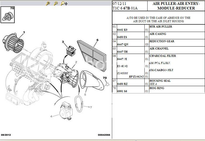

Re: Heater Blower
From the Service Box - unfortunately, there is no remove/replace procedure for it, but the pic may help. The list shows you have Item 04, but not 03.

Re: Heater Blower
On that diagramme My fan Blower Motor is only Part 1 and is located behind the glove box on a R/H drive Vehicle.
If i cannot remove the plastic rotor blades to get at the resistor i will need to re[place the whole motor blower unit
