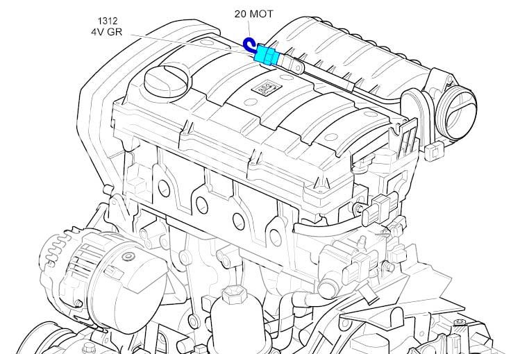

The combined MAP and IAT sensor is item 1312:
Part No 1920 AJ, and they are quite cheap - I would change that first. Then clear the faults and see what comes back. If the motorised throttle ones come back, it is the little box just to the left of the big circular air duct on the right. I would clean the electrical connector first, before changing it.

If you have put a new throttle body on Then you probably have a fault in the wiring. The MAP sensor MAY be a red herring as I think It's all in the same bit of loom as the TB.
Unfortunately, so many people think the codes just tell you which part to change and that will be the end of it. As you have found, that's not always the case.
