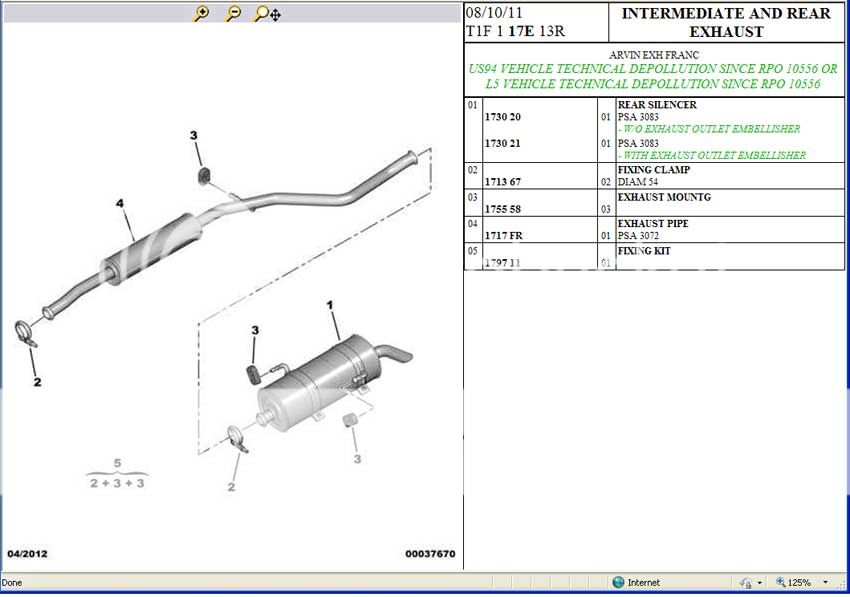

Appearance-wise, the "before Oct 2005" intermediate box is oval in section and just behind the joining flange, whereas the "post Oct 2005" intermediate box is circular in section and smaller cross-sectional area, and is quite a bit further behind the flange.
The rear end of the joining pipes are also different - one has a kink.
If you are going by what you currently have fitted, you may have the wrong part if it was previously replaced, but if it fits and you have no problem with it......
EDIT: I'll put up the drawings, and you can make a judgement.
