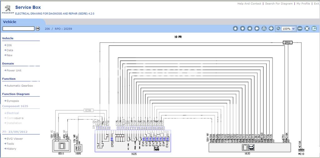

Item 1635 is the Hydraulic Block
Item 1630 is the gearbox ECU
Item 1005 is the starter inhibitor relay
Item BSI1 is the BSI (Passenger Compartment Fusebox)
Good luck !

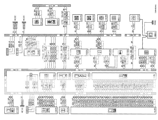

Slight hiccup. The drawing above is for a multiplexed car.
Yours is not multiplexed, so this is the correct drawing - unfortunately not in such a helpful format:

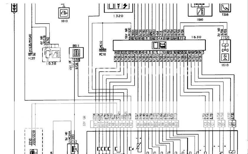

Does this help?
B1-B12 on the hydraulic pack all connect to the AT ECU.
Does this help?

Yep, this is what i want but on the picture you've cut the lower part which is the important part that i need.... Sorry for the bother man.

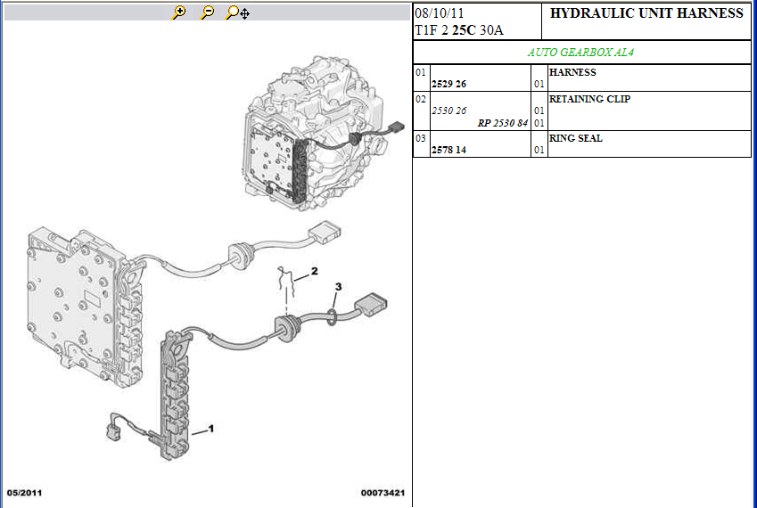

I think I understand now. That part is within the Hydraulic Pack, so it is treated as a replaceable item, and no repair information is available in the Service Box.
I think you need a replacement Item 1, Peugeot Part No 2529 26 :
Alternatively, this may help you do some detective work:

Yep you got right what am asking, the wires that go through the retaining seal are the ones that were cut. The last diagram that yyou sent me has the answer, i believe i can go through it but you have cropped the part am looking for, THE LOWER PART

Re: Hydraulic block wires
How's this?
