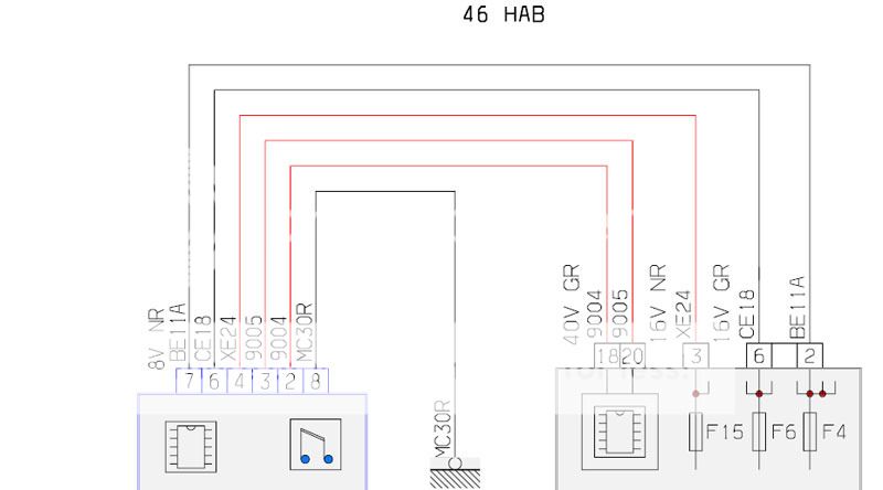

Hello there just bought the car and factory stereo did not work so bought aftermarket one took factory stereo out and cables have been cut and i dont no what wires go to what on the new stereo i have yellow wire for power red for ignition blue for antenna black for ground and one for each speaker thanks

There are too many variations to be precise about your car's wiring, unless you quote the last eight digits of your VIN.

Hi sorry about that its 42801978

The radio is the unit on the left, and the BSI, which supplies power, on the right.
F15 is the radio main power - on with the ignition
F4 is always on - the keep alive supply
F6 has something to do with the steering wheel stalks
I suggest you remove the door cards to sort out the speaker wire colours.
