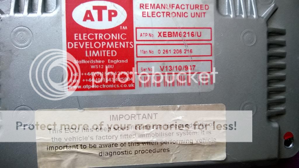

Alternator replaced battery fully charged car wont start Engine Management Light stuck on,
not getting spark and fuel pump not coming on (wired pump to battery and working) so there is no fault with the pump,
replaced coil pack new plugs,
replaced all fuses and 3 relays under the bonnet, and replaced all fuses under dash on the drivers side
have pluged in PP2000 and getting these error messages below,
can someone tell me where are the items below perhaps some pictures would be gr8 help
Cheak :
-transponder PEUGEOT
-ignition controlled + ve supply to control unit 1320
-Battery + ve supply to control unit 1320
-Built-in systems interface
-Analogue module 8220
Connect the adaptor (C1240): on Built-in systems interface BSI.
Switch om the ignition.
W Reg 2000
if you are needing anymore info please let me know and i will give you what you need,
