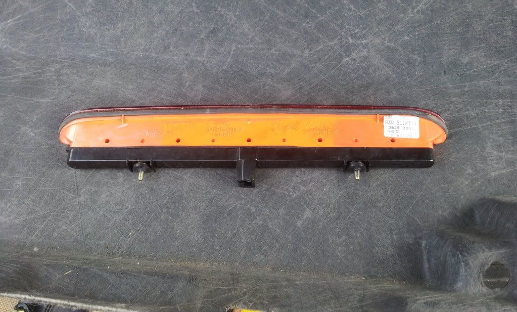

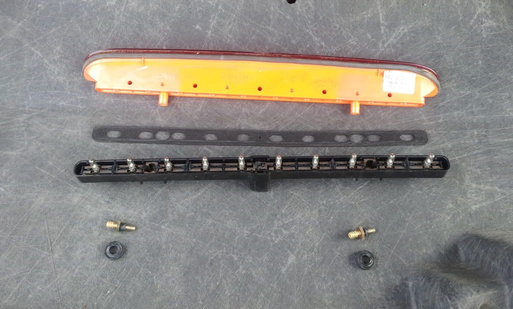

Felt better today and it was actually a blue sky where I live, so I delved.
Took the 3rd brake light out using the traditional method. On examining the unit it had the 2 retaining bolts looking like they were bonded in to the fitting
, this is not the case, they are screwed through the rear black bulb-holder part of the light into the main body of the lens
(coarser thread on this section, and what looked like a nut was mid-section of the bolt). Having separated the two parts I discovered that the bulbs are standard type, and through a little net-trawling I identified them as R284 12V W2.3W Indicator & Panel bulbs. Not being able to source them locally, I have ordered and reassembled light for now.
I intend to replace all in one go (10) and when I do will try and remember to take some pics for info.

New bulbs arrived and I can confirm they are the correct style, fitting and wattage, side by side comparison with the old (and completely unmarked) bulbs bears this out as does a test with old and new alongside each other in the brake fitting when lit.
I have edited the previous post I made and included a couple of pics.
However I have found that my bulb wasn't at fault but the actual bulb holder. The end holder has broken. There are 4 spring elements to hold these bulbs in place, one of mine had snapped at the base and wasn't keeping the pressure on the bulb to make a proper contact.
I know have a lopsided 9 bulb brakelight until I decide how to deal with it
