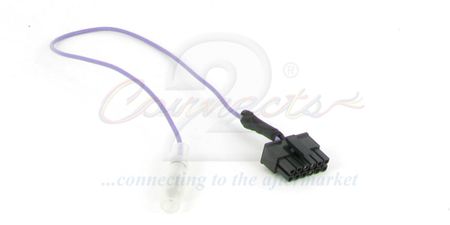

First i found this part: https://d11tezxtmr089.cloudfront.net/im ... 40x840.jpg
Just the cable on the picture.

Yes those parts should be fine. No you shouldn't need a frame to make it look good. The info on the mfd depends on what stereo you had from the factory... lower units had no integral display and so put all their radio station/ track number info on the mfd. You will lose this but it should still give you all your obc data such as range remaining, outside temp etc.

It should all still work apart from the radio related display. The later cars had headunits with no display so it need that MFD unit. That will now be in the new radio.IanL wrote:I don't have any experience of this, but just a word of caution. I understand that most, if not all, substitutions of the radio will not permit any relevant data on the multi-function display.
I haven't changed a later one but I swapped out the CD eating Pug unit from my daughters old 2001 CC and it was dead easy. I just had to swap a red and yellow cable to keep the station memory alive. Even that was part of the Sony kit .. an adapter cable. We didn't bother with the remote stalk .. it was generally used with an MP3 USB stick.
On later cars the radio is coded to the BSI (early ones had their own code) .. so if you take it out it thinks it has been stolen. I think it "bleeps" at you .. which I guess could be pretty annoying. You need PP2000 to remove it from the BSI config.IanL wrote:Also, I recollect seeing an option in PP2000 relevant to the fitting of a 3rd party radio, so you may have to use PP2000 to get it working.
