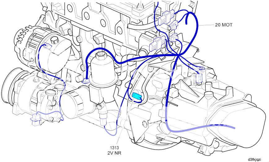

Hey guy I've got a error code saying that the camshaft position senor is having issues. Now I've heard that for peugeot this means that the crank speed senor is what I should be looking for. So my question is where can I find it?
I have a peugeot 206 1.6 2005.
Crank speed location?

The item marked 1313

If you are getting a cam shaft error then both the 1.4 and 2.0 DOHC engine have a CAMSHAFT Sensor ... not sure about the 1.6 as it's not listed in my manual

!.6 hasnt got one (don't think the 1.4 has either as it's a smaller version of the 1.6)

Mentions one in the 1,4 section of my Haynes .. but then again ....
